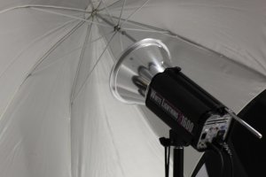

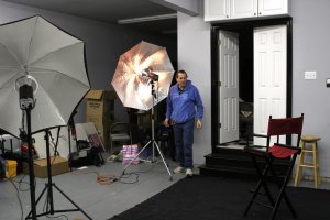

Dear Wes.
Here are the Simple  Studio Lighting systems that I have learn from the PRO, The Lighting sources are depend on your money---From Cheapo to high end.
You just  try from the cheapo first, such as the Umbrellars from 20 Us Dollars and your Flashes.
Good Luck.
Surapon
