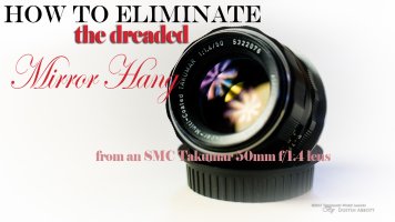

Hello everyone.  I discovered a very quick and easy way to solve the mirror hang issue with Canon full frame bodies and the SMC Takumar (or Super Takumar) 50mm f/1.4 lens.  These lenses are still very intriguing and are inexpensive to grab off Ebay or a pawn shop.  If you're interested, check it out:
http://bit.ly/1EW5Jxx
