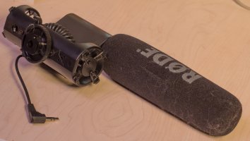

I have shot video with the 60D and the 5DII. On both cameras you can hear the IS. My solution is to turn off IS if using the internal mic, or the better solution, get an external mic. Just about any external mike will beat the in-camera mic. The key thing to look for is some form of isolation from the mic stand, or if hotshoe mounted, from the camera body. The lower picture shows details of a hotshoe mount... the green line points to the hotshoe mount, the red lines point to the elastics used to isolate the microphone from the mount, and the blue lines point to hair shed by Fluffy the cat. (cat hair is optional).
