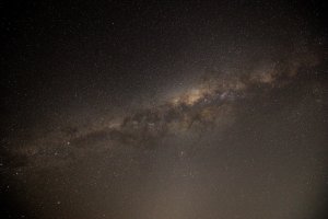

Here's a recent milky way shot - EF 16-35 f4. Sorry I couldn't upload the full sized one (8192x5464) as the forum couldn't digest it.
So here's a 3000x2000 one.
Lightroom lens vignette correction has been applied, but not the distortion correction. You can see the higher noise in the corners, except the bottom right one where it was light polluted (still noisy in the very bottom right tip).
2) corner-exposed, software-corrected image that shows blown-out highlights in the center. Again, even by itself would be very instructive, and show that simply exposing for the corner isn't an adequate solution.
It's not an adequate solution because it's generally meaningless and not practical. In makes no sense in astro and it makes no sense when doing ETTR.
3) image (1) or (2) but without software correction, as it'd be interesting to see if the corrected version is ever actually worse than uncorrected,
The same image without vignette correction.
Thanks for the example. The debate/argument here is about the complaints from some people that the RF lenses designed to require digital correction of the distortion are ‘horrible’ or ‘unacceptable’. That your example of this terrible, no good, very bad digital corner mangling comes from an EF lens effectively pours cold water on their (il)logic.
The images are still usable after corrections, but note it's 16mm, and the lens in question is 24mm at its wide end. So we may expect less vignetting, probably. But the fear is it can be worse - we just need to wait for the proper tests/measurements on that lens.
If we're concerned about the RF lenses being worse that the RF lenses, it's a bit different question. In this case proper comparisons should be made between, say, EF 16-35 f2.8 and RF 15-35 f2.8.
The RF 15-35 at 15mm f2.8 has 4.6 stops of vignetting:
The same 4.6 stops in EF 16-35 at 16mm f2.8:
