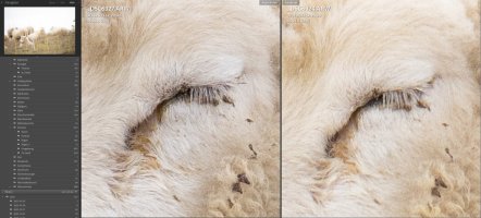

I have a 135mm f1.8 lens and a 400 f2.8 Lens.
While the 400 f2.8 has "perfect" mtf charts and the 135mm f1.8 does not, the 135mm f1.8 shows way more sharpness in a field test.
Im talking about the sony lenses here. I tested this with the 61mp a7r iv.
I shot a testsubject and framed it the same with both lenses, meaning i had to walk further away with the 400mm lens.
Tests were shot with a tripod and a remote shutter. The results also align with my experience with these lesnes from months of use.
How can this be? Shouldnt the 400mm f2.8 be clearly sharper according to the MTF charts?

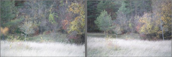

Second reason for me is, that i actually find it shows too little background. Attached is a comparison between 400mm and 135 with same framing. The 400 "zoomes" the background in too much. I do Environmental wildlife photos and i prefer more environment in the photos.

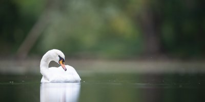

Some examples attached.
The first one is a swan with 400 f2.8. Its nice, but also you dont really see much of the environment and even if you wanted to show it, the swan would need to be like 80 meters away which is not practical in many situations. With a 600 this would be worse.

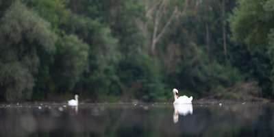

On the other hand with 135 you can show the envionment (see attached picture), but sometimes its not blurry enough or the animals are too far away. 200 f1.8 is the perfect middle ground here and gives maximum blur like nothing else, while still showing the environment.
