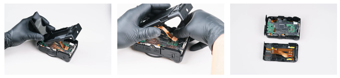

Kolari generally starts with removing the baseplate from the camera they are breaking down, but in this case, there isn't one. The front and back of the camera are sandwhiched together.
There are only a few screws on the outside of the camera that have to be removed before it can be opened, and then it's just a single ribbon cable to remove to get the cacmera in two halves.
The next step was to flip the camera over and remove the bracket frame, which you can see above.

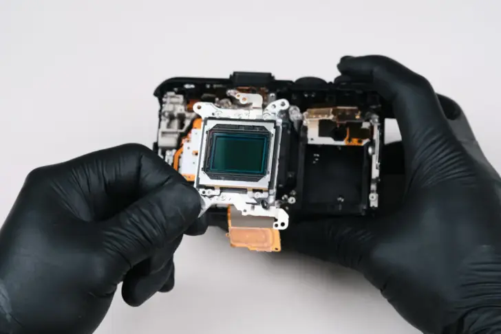

Once that is done, it's time to remove the PCB, which looks to be the most difficult part, as it has 10 ribbon cables attaching it to the camera functions.
One the circuit board is out they could move onto the camera sensor bracket, which is held in by one screw. Though, they do not previous screws that were removed likely secured the sensor bracket more securely.
It looks like Canon has done an efficient job of putting the EOS R50 V together, and that's nice to see.
