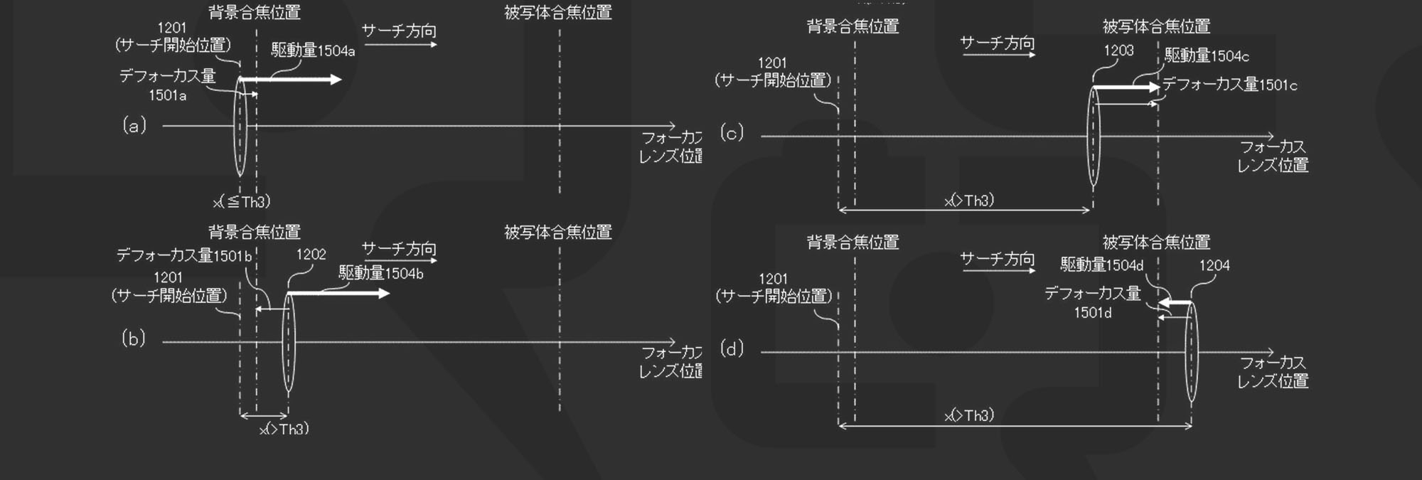

In this patent application (2024-073200) Canon is looking at improving the racking of the lens from near to far to find focus quicker.
As you may be aware, major defocus happens when the contrast is too far out of focus that it’s just soft with no visible contrast. When this happens, it’s nearly impossible for the camera to judge how far to move the lens to achieve focus. This is when the lens goes “hunting” for it, which usually is a dreadfully slow process as it racks in and out from near to far.
Canon in this patent application, looks to change that with some intelligence in the camera to set defocus ranges and use that to quickly isolate where the plane of focus is.
Major defocus is a major problem with mirrorless, so Canon finding a resolution to one of the greatest weaknesses of mirrorless would be a wonderful thing for us users.
As with all Patent Applications, we may or may not see this implemented but it’s encouraging that Canon is still researching ways to improve this and not just going “Meh, it is what it is.”
Source: Japan Patent Application 2024-073200
