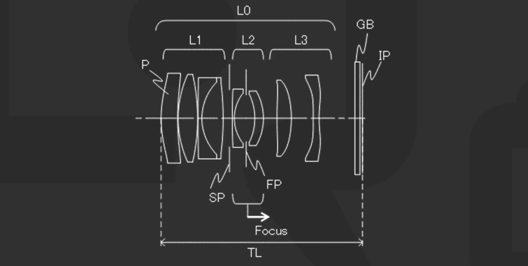

This patent application (2023-149130)shows some interesting and fairly simplistic optics for 70, 75, and 85mm primes.
The 85mm primes are unlikely since we already have the Canon RF 85mm F2.0 IS STM. It should be noted that the element designs in this patent application are far simpler than the 85mm F2.0. Most likely because of the lack of a macro capability and quite possibly optical quality as well. But with the Canon RF 85mm F2.0 only $599.00, you'd have to think that's as low as Canon would go.
I don't see the utility then of this patent application, outside of some interesting different designs. It's unlikely that Canon would develop a 70 or 75mm prime, which is something I don't think Canon has ever developed, even back in the FD days.
Also, the back focus distance seems to be far more fitting of the EF-M mount than the RF mount, but Canon certainly isn't going to make these for the EF-M mount anymore.
These are very tiny primes with a lens length down to under 50mm which is never a bad thing, and the designs are interesting so here we are.
Canon RF 70mm F2.0
Focal length:         70.00
F value:               2.06
Image height:         21.64
Total length:         78.88
Back focus:           16.48
Canon RF 70mm F2.8
Focal length:         70.00
F value:               2.83
Image height:         21.64
Total length:         68.97
Back focus:           17.41
Canon RF 75mm F2.4
Focal length:         75.00
F value:               2.40
Image height:         21.64
Total length:         86.00
Back focus:           15.64

    • Lens patents are protections of optical and mechanical design formulae, not the specific solutions to those formulae shown as examples.
    • R&D department's goal isn't narrowly to fill in gaps in their own firm's product line, but rather, to maximize revenue for the firm. Even if tied directly to the product line, a patent with a worth of zero WILL NOT be filed, while a patent with zero relation to the production line but of great worth WILL be filed.
    Nearly weekly this site discusses the examples given of applications of the design principles the patent covers, as if those examples are in fact what is being patented. Not the case. Patents that don't seem to have an application to the MILFF product line directly may be intended as bases for future patents that will be of more use, or, for product lines you're not aware of. (Canon makes optics for everything from semiconductor photolithography to security cameras to military optics.) Patents may also be thought to have little value, but more value than the cost of filing them. Patents may also be more explicitly to license to other manufacturers, or to block other manufacturers from making products they'd otherwise pursue.
    You can read the "scope of claims" 請求の範囲 to see what the patent is actually protecting. Nowhere does it mention the patent is limited to 70, 75, or 85mm lenses. If you don't read Japanese, Google Translate seems to work fine on this material:
    特許請求の範囲】
    【請求項1】
    物体側から像側へ順に配置された、正の屈折力の第1レンズ群、負の屈折力の第2レンズ群、第3レンズ群からなり、フォーカシングに際して隣り合うレンズ群の間隔が変化する光学系であって、
    前記光学系は、接合レンズを含み、
    前記第3レンズ群は、非球面レンズを含み、
    フォーカシングに際して前記第2レンズ群が移動し、
    前記光学系において最も物体側に配置された第1正レンズの焦点距離をfp1、前記光学系の焦点距離をf、前記光学系の光学全長をTLとするとき、
    0.0<fp1/f<2.0
    0.8<TL/f<1.2
    なる条件式を満足することを特徴とする光学系。
