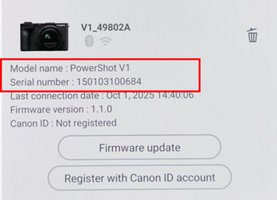

In some units, the serial number is not registered correctly within the product. As a result, the following issues may occur:
  • When connecting the camera to a PC or mobile application such as Camera Connect an incorrect serial number and/or product name might be displayed.
  • The EXIF information stored in captured images may display an incorrect serial number and/or product name
  • Unable to register the product to a Canon ID account through the Camera Connect app.
    *The products can be registered manually via the official Canon website

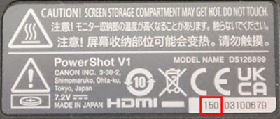

Affected Compact Digital Camera “PowerShot V1” units that experience the issue described above have a serial number starting with the digits “155” and “156”.
The correct serial number is a 12-digit number printed on the label located on the camera body, visible when the screen is opened.
Recommended Method of Checking for Affected Products
Please connect the camera to the Camera Connect app to check the product information.
The affected products display incorrect serial number and model name.
*For detailed instructions, please refer to the “Bluetooth Pairing and Wi-Fi Connection to Smartphones” section in the Canon PowerShot V1 Product Manual.
(Canon : Product Manual : PowerShot V1 : Connecting to a Smartphone or Tablet)
The correct information is as follows
・Model name: PowerShot V1
・Serial number: the serial number indicated on the product body
