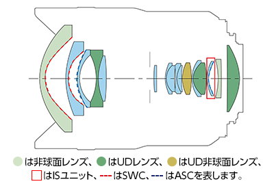

Translated roughly: The Light Green elements are aspherical elements, the dark green elements are UD elements, and the olive-colored element is UD Aspherical. The red Square encapsulates the IS element.
As far as coatings, the Red dashes on the elements are SWC (Sub Wavelength Coating) coatings. The Dark blue/black dash is ASC or Air Sphere Coatings. Canon has placed multiple sub-wavelength coatings which are essentially nanoparticles to prevent flare and ghosting and also Air Sphere Coating, which looks like little nano balls deposited on the element surface.
The Canon EF 11-24mm was released before ASC and simply had the SWC coatings in similar element positions as the RF 10-20mm. So if you are happy with the flare response on the 11-22mm then you should be as equally happy if not more on the RF 10-20mm.
