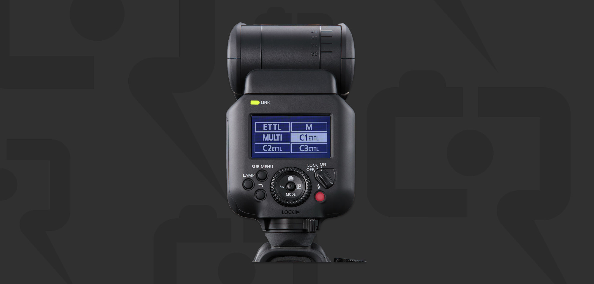

Canon has released new firmware for the Speedlite EL-1, EL-5 and ST-E10 transmitter. It is a small update, but may be a great thing for anyone using these Speedlites.
Firmware Version EL-1: 1.1.0 & EL-5, ST-E10 1.2.0
  • Wireless communication stability has been improved.
You can download the firmware here.
