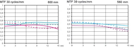

The reliable and friendly Swedish experts have measured the MTFs of the 100-400mm II, including the 1.4xTC to go with their earlier tests on the 300mm f/2.8 (+1.4x and 2xTCs), Sigma 150-600mm S and Tamron 150-600.
http://www.objektivtest.se/tester/canon-ef-100-400-mm-f45-56-l-is-ii-usm-test/
On full frame: at 300mm, the 100-400 II at f.5.6 is very close to the Canon prime and beats the Sigma and Tamron, with similar results at 420mm for the 300 + 1.4xTC and 400mm on the other two. The 100-400 II + 1.4xTC at 560mm beats the Tamron at 600mm and is as good as as the Canon prime + 2xTC and the Sigma.
On APS-C, at 300mm the 100-400 II is as good as the 300/f2.8 and better than the others, repeated at 400mm (420mm on the 300 +1.4x TC). The 100-400mm at 560 easily beats all the others at 600mm.
The results bear out my own experience, especially that the 100-400 II + 1.4xTC is sharper than the 300mm II + 2xTC on the 7DII, which initially surprised me. However, on FF he 300mm II + 2xTC is still king.

AlanF said:
On APS-C, ......The 100-400mm at 560 easily beats all the others at 600mm.

Still the MTF charts from the mentioned site do not seem to agree 100% with you.
http://www.objektivtest.se/tester/canon-extender-ef-2x-iii-test/
But even if they are very close or equal it is a huge success for 100-400...

I think you should direct this post to AlanF. I didn't make the comparison. I just state the fact that the Digital Picture's test method isn't very reliable.

But the MTF tests of the other site do not contradict TDP site comparisons...
Anyway I do have 100-400. Up to now I have used it with or without the 1.4XIII and I quite liked it (even at 100% magnification).
I just made sure to close it 2/3 of a stop to make sure I get top IQ.
So the results so a fantastic 100-400 II zoom anyway. No reasons for frustrations. I like my 100-400 II very much :)

I agree with you, the results looks rather similar. What camera are you using your 100-400 II on?

I understand where the queries concerning the MTFs arise. They are similar. My reasoning for the 100-400mm being better for the APS-C 560/600mm data close to the centre was: the 300mm x2 at f/5.6 has an average MTF for sag and merid of 0.484 and f/8 0.524. There is astigmatism for both as the sag and merids do not converge. For the 100-400 II at f/8 the average is 0.507 with astigmatism but at f/11 it is 0.538 with no astigmatism.
I have the 300mm f/2.8 II and the 100-400mm II so I have no owners bias to either lens and love them both.
