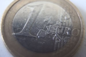

I thought I'd throw in two macroshots to show what money can get you which effects. The first was made using a 17-40@40mm/f/4 and three extension tubes (13, 21, 31mm) for maximum effect. You can add more tubes to your heart's delight. These tubes have metal mounts, electrical throughput and the three are to be had for about 60-70 usd on eBay. I've not paid any attention to lighting and the such, but you can see that my 23mm coin almost fills out the 36mm of my 5D3 sensor. Great for product detail photography, jewelry, and larger bugs (which I shun like the damned plague).

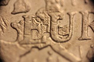

The second one is the same coin shot with a reversal ring: the 17-40 was attached in reverse to a 70-200 f/4. This required a lamp since stuff is getting pretty dark at this magnification level (hence prolly the yellow hue). Bugs will start complaining about being stared in the unmentionables (or so I hear. I really do not dig bugs). The ring cost me three dollars tops, the lenses a wee bit more.
This is all the macro I will ever need. My needs are pretty modest though, but still - great for experimentation and for me, just the right amount of money to be able to conclude: nice to have, but that's quite enough. Bleedin' bugs ::)
