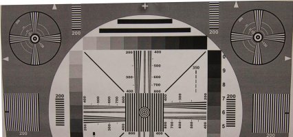

I am more confused now... with every shot I take with the 17mm, it seems to get sharper... I don't know why. I did as you said and did some test shots. 17mm was stopped down to f8 and the 70-200mm was left wide open at f4 ... so the 17mm did have a bit of an advantage... tell me what you think of the 2 test shots. First is the 17mm @ f8 @17mm

Guys: Can you please look at these pics I took for my 4 lenses (File names tell you what lens and settings they were shot at):
All were manually focussed
ALl on tripod
IS disabled where applicable
100mm did not have a UV filter attached, rest did
Which one looks good?
17-40mm L F4
28-135mm IS
70-200mm L IS F4
100mm L Macro F2.8

MF, ok. Shoot the same target with AF (a few shots). If MF is sharp and AF is soft, you can either exchange the lens or send it to Canon (that's where a body with AF microadjust is nice!). If both are sharp, relax and enjoy your new lenses.

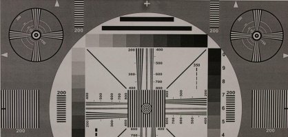

Returned the 17-40L, and the 70-200L f4, got the 24-105 f4L and the 70-300mm f4-5.6L IS. And they are both noticeably sharper than the ones I returned...
2 chart crops. All settings default Camera raw for these. (just did auto exposure/ tone to get some contrast) all other settings of Adobe camera raw = default.
