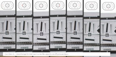

Many thanks for the replies. I shall re-calibrate with the 50x lens focal length. I have done this for the 50 1.2 L already and have attached the results - a series of pics focusing on the same part of the chart with the most common AF points I use. The lens was calibrated to the center point. Positioned 2.5 meters from chart (50 x 50mm), camera on tripod with 2 second timer. Chart is mounted on a window so had strong back light. I ran this test twice and got the same results both times so I don't think it is a matter of inconsistent focus - it's consistent for the calibrated point and simply consistently out by different amounts on the other points.
The product advisory on AF sounds to be describing the issue. There are no painted dots in the battery compartment and the firmware is 1.2.0 so I'll upgrade that for the next tests too. I'm kind of wondering if one of those has more consistent AF then it may be better to switch rather than potentially always being unsure about AF point accuracy on this body. Even if it's fixed by Canon it may only take a slight bump to knock it out again? Does anyone know of any AF accuracy tests for the 5d3 or 6d using 1.2 lenses?
