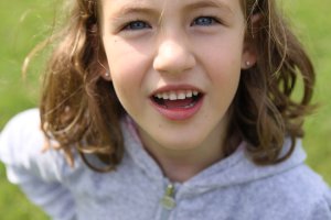

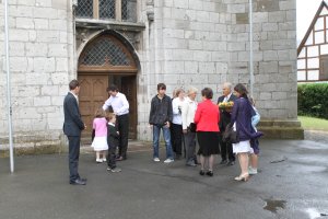

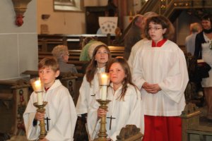

the last days I took a look at the pictures I had taken with these Lenses and I noticed that they were all (but one, and that isn't as sharp as my Tamron 17-50 VC) not sharp at all and blurred. And now I don't know, what the problem with them is. Front/Back - focus, or are they both decentered (I don't know, if it is the right word)., or maybe I was just too stupid to use them properly.
I've selected a few pictures to show them to you. Maybe you have some ideas.
regards
Grisa

First off, did you shoot in JPEG or RAW and did you have high ISO noise reduction on or off?. The first image is taken at ISO 1600, which is pretty high for the 500D, the noise doesn't look that bad for such an ISO, so I suspect there has been some noise reduction, which will soften the image. Also, there appears to be some motion blur if you look closely and I would say that is partly down to camera movement, as the pews have a double image. Certainly, the shutter speed is marginal at 1/60th at 59mm.
The second image - it's difficult to say where the point of focus was, but again there may be some movement, although the shutter spped should be high enough, provided the subjects weren't moving too much. However, at 24mm, the 24-70 is probably at it's weakest if it's anything like the 24-105. Certainly, there is visible fringing, which will affect image quality.
The third image looks ok to me, the depth of field is very narrow, but otherwise there are some very sharp areas and the eyes look acceptably sharp too.

Shot 1, definitely motion blur.
Shot 2, can't tell what you're focusoing on.
Shot 3, looks quite sharp, although the DoF is very thin as you'd expect at f/2.8 with a close subject.

1: This is motion blur. It's always better to increase ISO than to have motion blur. Grainy photos are workable, blurry photos are not.
2: Castle wall is in focus, there's just motion blur. Increase ISO to 200 and decrease shutter to 1/120 and you'll see better results.
3. Both the girl's eyes are in sharp focus -- not sure what the issue is.
