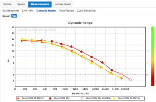

You seem to be drawing conclusions that aren't supported by the data. I suspect you're looking at the DxOMark Scores (which are biased in favor of their priorities, which aren't the same as everyone's).
For example, if you compare the dynamic range 'score' of the 5DIII, 1D X and 1DIV, they're not all that different. However, DxOMark only considers ISO 100 in their score. If you look at the Measurements for DR, you can see that starting at ISO 800, the 1D X has the advantage, and by ISO 3200, that advantage is nearly a full stop of extra DR.
As for noise, DxO only tests full stops. But in Bill Claff's data, you can see the jagged lines of the noise at the 'tweener' ISOs in both the 5DIII and 1DIV, whereas the 1D X is a smooth progression (with less noise than the 5DIII throughout, and less noise than the 1DIV from ISO 800 and up). That smooth progression is a result of the 1D X's better electronics. IQ from the 1D X is very slightly better than the 5DIII, and that can help, espeically when you push the files a bit in post (or look in detail at noise quality, for example in these crops from the thread you linked). IQ from both the 1D X and 5DIII is better than the 1DIV.
However, the differences are subtle. While there's not 'no difference', the IQ difference between the 1D X and 5DIII certainly not a differentiating factor between the two cameras. That's ok, though - there are plenty of differentiating factors (for most people, price being the first and foremost!).
