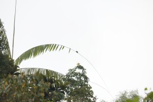

First, resolution.
A pair of birds miles away, that I couldn't see what they were. But there is just enough resolution to to see that they are Black-crested bulbuls. Then there are some birds that are reasonably close but crop extremely well.

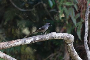

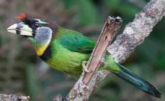

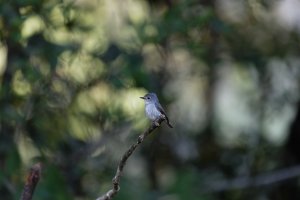

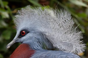

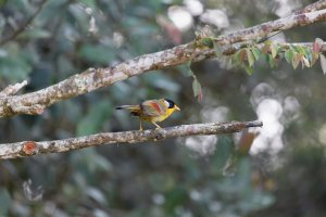

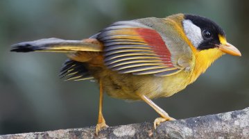

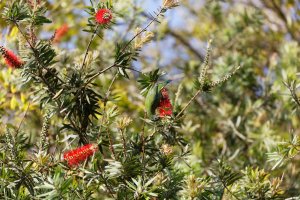

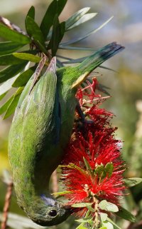

Here are some higher iso jobs I couldn't have done with the 7DII. The female orange bellied green leafbird was at iso 2000, and close enough for a good shart. The Large Niltava was very far away, in the shade, and taken at 1/30s and iso 2500. Not a publishable shot but OK for my album. No sharpening, of course. (All hand held).

Did you find the fine feather filaments exhibited any moiré, given the lack of a functional AA filter on this camera?
neuroanatomist said:
Yes, as exemplified by the orange bellied green leafbird image...
I didn't click on them full size :) Also resizing can affect moiré can't it? Either way, I'm sticking with the non-r model - I don't need to pay an extra £200 for a feature that might make things worse in critical images.

Good morning here from Hong Kong. The Moire seems to be introduced by using DxO as the RAW converter. Here is the crop from using DPP4 to convert, which is noisier (no sharpening or noise reduction applied) but lacks the Moire in the long tail feathers and on the left of the DxO. The regular repeating patterns of the feathers in this shot are perfect for setting up Moire, independent of having a low pass filter. Otherwise, I haven't seen Moire patterns.

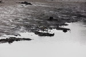

Finally, don't bite off more than you can chew.
I couldn't see what the stork was doing until I saw in this on the screen.

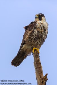

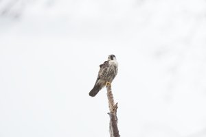

Thanks for starting this post Alan. Glad you're enjoying the 5DsR for birding. Unfortunately I have not been able to spend much time birding on my business trips to Malaysia. Beautiful country. Here is a sample of a Peregrine Falcon I found on a recent trip to Bombay Hook, Delaware. 5DsR, 600 F/4 (non IS) with 1.4MIII TC. 1/640, F/8, ISO 800. This was a rainy, overcast gray day. Hoping to do better this weekend.
There is less moiré in the DPP4-converted image than in the DxO-converted image, but it's definitely still there. So I suspect that DxO is just accentuating it (e.g. with 'lens softness correction' / sharpening).
