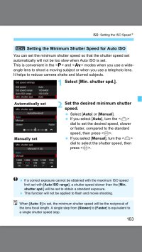

You can change this by up to +/- 3 stopsneuroanatomist said:You can still be a handheld shooter, just realize that 1/FL won't cut it. That also means setting a minimum shutter speed or shooting in TV or M mode, unless Canon changes their firmware logic which still uses 1/FL (1/1.6xFL on crop).

rs said:You can change this by up to +/- 3 stopsneuroanatomist said:You can still be a handheld shooter, just realize that 1/FL won't cut it. That also means setting a minimum shutter speed or shooting in TV or M mode, unless Canon changes their firmware logic which still uses 1/FL (1/1.6xFL on crop).
