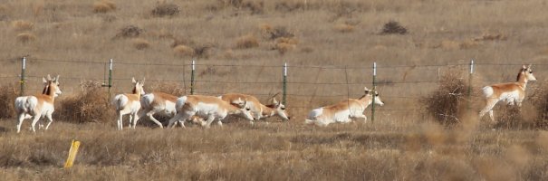

I just ordered a 5DS R which hasn't arrived yet. Currently I am using a 6D and 400mm f/5.6 for BIF, but use my 100-400mm II for other wildlife where IS is helpful. One is lucky to get within a few hundred yards of an antelope herd, so I am anxious to see how the 5DS R, 100-400mm zoom and 1.4X TC III perform together. I shoot everything handheld, and a 500mm or 600mm big white is totally out of my comfort zone for cost and weight. In Alaska I shot a Sigma Sport 150-600mm briefly, and it seemed impractically heavy for me. The owner was less than half my age, and produced stunning breaching whale shots with his Sigma. I never have enough reach with wildlife, so I am hoping the TC will be a net benefit vs. cropping the 5DS R image. Since I will now be able to AF with an f/8 lens/TC combination, am I expecting more image quality than the 560mm focal length can deliver? Thermal air distortion is a real problem in Colorado at 1000 feet. Also, will the TC work on my 400mm f/5.6? The bare lens isn't listed in Canon's recommended 5DS chart. Here is an example of what I currently can capture with a 6D & zoom for antelope at about a quarter mile away.
Seems like an ideal situation for a portable blind??
