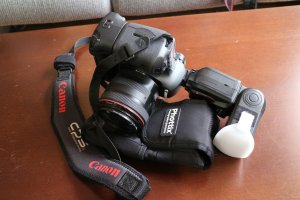

I use Flash = Phottix Mitros+ ( can control Phottix Odin) for 12 months , and never have any problem with my 5D MK II, 7D, 7D MK II and 5D SR.---BUT, I always use spot meter ( as recommend by our friend Mr Graham.) to get the perfect flash at the face of the model not matter of back light. Plus I set up the Thottix Flash as ETTL AND HSS= HIGH SPEED FLASH SYNC. AND USE MY CANON AT TV. MODE and set shutter speed at 1/ 125 sec. for take most of my photos with minimum vibration blur by my old hands shaking.
