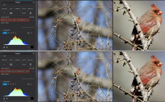

My idea above that I could edit the EXIF and at least get DxO to use the lens profile for the 600/4II + EF 1.4xIII turned out to be possible with a fair bit of digging. Through some trial and error, it turned out that there is no need to change the Lens Model or Lens ID number in the EXIF, all that's needed is to set the Focal Length to 840.0 mm and set the Aperture to 5.6, then DxO correctly 'guesses' that the combo is the 600/4 II + EF 1.4xIII. (Took a bit longer to get there since Exiftool reports "Sorry, Aperture is not writable," because the real name of that field is fnumber.)
So, does it matter? The lens profile (albeit with the 'wrong' extender) corrects a very small amount of vignetting and barrel distortion (easier to see when dynamically flipping between the images rather than the static images below), but the lens-specific sharpening does make a noticeable difference. Could have gotten there by doing that manually, I suppose. The file with the original EXIF is on top, bottom panels are after changing the focal length and aperture in the EXIF metadata.
So at this point, it's mainly academic. I have a functional combination of 600/4 + 1.4x extender, and a working lens profile for easy RAW conversions. I could buy a used EF 1.4xIII (B&H has a 9+ copy for $300), but I don't really see much point.
