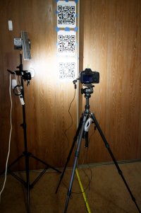

I use a pretty simple rig in my office for a 15' range shown in first image. The target is taped to the closet door at one end of the room, checked for plumb/level. The tape measure on the floor let's me easily adjust target distance. The target was printed at 150% to fill the page. You just need to remember to modify the "large target width" on the Tests Preferences to the size of the target if you choose to do this since the target width increases from 128mm to 192mm.
A light stand holds a PAR30 5K 15 watt 800 lumen LED reflector bulb in a Manfrotto Double Super Clamp at a 30-45 degree angle from target to minimize reflections. It's a bit close to the target now to accentuate the effect. I usually kill other lights in the room and close the blinds (even during the day) to minimize reflections/interference and shoot with spot metering on the target.
The LensAlign tool is mounted atop the stand at eye-level so I can easily verify AFMA after FoCal. It is also a good way to practice holding the camera still/steady when shooting with narrow DOF. You'd be surprised how much sway you can impart to camera between focus and capture. Shooting continuously can give you some idea.
I use a three axis level in the camera hot shoe once mounted on the tripod and measure distance from floor and side wall to camera and target centers to ensure it's square. You can also verify with a mirror taped in front of target if you aren't sure. I verified the setup with a mirror the first few times, now I don't bother.
A cheap, powered USB hub hanging on the tripod doubles the distance from my Mac which is on the side wall, allowing me to move the camera from end to end in the room. The Mac is near to door so its easy to setup in the hallway for longer lenses. I've also got a laptop if I need a longer test range.
