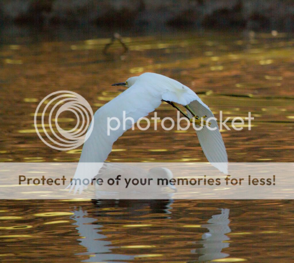

I am currently using a 7d for bird in flight photography. I get unacceptable levels of noise when I crop the photograph when the ISO is 400 and above (even at 200 it isn’t great). I’m using a 100-400mm lens. Should I send in the camera for service? Should I upgrade to a used 1d mark IV? Or wait until the 7d replacement comes out? Price range is 3,500.00 give or take an or leg. I shoot raw (max) and use LR4 for initial processing which is where I see the noise.
They seem noisy. Are you pulling up the darks in that first one?

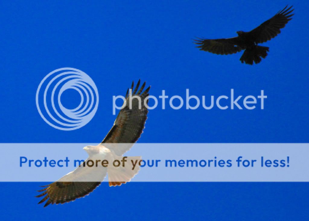

I'd love to get those images. Be quite happy. The hawk and crow was at iso 400, 5.6, 1/2000th. They are about 500 feet which is a reach. Very soft to my mind. One of the things I have to keep in mind is whether I've reached my equipment edge or have a great deal of learning to do. I'm trying to eliminate the most likely suspects as it were.

BIF are obviously are challenge to capture, maybe you could setup and do some testing using a plastic toy under similiar lighting conditions so you can have a good play around without worrying about the 'bird' disappearing. The other thing is they looked a bit under-exposed to me, are you increasing the exposure in post?
The second photo has a huge amount of banding. The only way I can get my 7D to band that bad is to underexpose a shot by at least three stops, and then crank it up again in post processing. This causes a lot of noise and some banding. Do you underexpose your shots often and find yourself adjusting the exposure a lot in post processing? That could be part of the issue.
westr70, as relative new owners of the 7D as well as nature/bird shooters, make sure you go through and set all your Custom Functions because there are a couple of crucial ones that you might need to adjust to your shooting style. Also, try shooting auto ISO and compare your results. That 7D is a peculiar bird, so experiment and report back if u can. Thanks and happy shooting. :)
@ michi. Yep, that egret flew into the shadows and I had to crank up the post processing to get at the image. Well, at least I understand what the banding was. Thanks for your experience.

How about that top shot of the hawk and crow? Any ideas on how to fix that other than buying a ladder?

You hear a lot of talk about DR, and a shot like the top one is a good example of why you want all the DR you can get. Being able to get detail in the dark areas without blowing out the sky is going to be nearly impossible. Expose manually or use EC to get the bird properly exposed and let the sky blow out.
Your camera is calculating exposure over the entire scene, and essentially exposing for the sky, when you want to see the bird properly exposed.
In post processing, you can create a mask and bring just the exposure of the sky down to help out a little, but trying to add light to only the bird is going to cause problems.
I have a 7D, and I'm with Michi, that a 3+ underexposure will bring out all that chroma noise and banding, which is the main issue with the second shot. (Chroma noise is the colored noise, while luminance noise is the black/white splotchy.) I bet that one was pretty dang dark out of the camera!
You miiiiight be able to limit the chroma noise in shot 2 a bit by doing this in Lightroom: (I actually only have Lightroom 3, so not sure if LR4 is set up the same..).
Under Develop, scroll down to the "Detail" section, and in there is the Noise Reduction section.. Then bump up "Color" from 25 (default) to around 35-40.. It miIIiight dull your colors just a tadd, so them bump your contrast a couple notches and your vibrance.. It should bring the image back pretty well, without all that chroma noise.
As for your first shot, I don't have much experience with nice blue sky pictures.. That looks like a lot of noise, though. Also, how much did you crop that shot? It looks like it's pretty close to a 100%, so you pretty much max-cropped? That would be my guess, anyway.. If that's the case, there's not much you can do besides getting a bigger lens.. The hawk doesn't look that bad, really, just a bit tiny!
You can also try messing with the Luminance noise reduction in the hawk shot, and then do sharpening, though.. And if you hold down Option/Alt (on an Apple at least.. not sure if it's the same button on Windows..) you can see the "sharpening mask" as you adjust it, which essentially defines the sharpening edges.. It'll let you not sharpen the noise, while still sharpening the hawk. (Hold down option, and then click and drag the "Masking" bar under Sharpening, which is juuust above the Noise Reduction, you'll need for your second shot.).

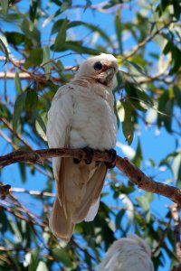

Hello,I have just recently started using a 7d.Within the sample photos I agree that it is under exsposed.Are you using your histtorgram?Also iso seems a bit high.I shoot @100 most of the time.As for noise I have also shot @ night with 1600 no problem.Filters are also reccomended as well,weather it be uv or polarised.Post production I do is minor,i.e colour balance etc.I hope this helps.See photo for what 7d can do
