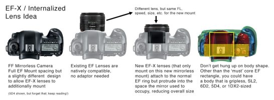

Someone came up with an idea, and someone else a graphic to illustrate it, of EF fitting normally and RF lenses having the rear element/s protruding into the camera body.
This way you retain 100% adaptor-less compatibility with EF lenses and RF lenses can still benefit from getting closer to the sensor & have a small(er) camera+lens size.
I don't know enough to have any idea whether this will restrict potential designs for RF lenses.
Yes. This.
Head here to read the team's take on it.

For this reason (reliability), I believe the sensor will be fixed at the standard EF flange distance and new EF-R lenses will simply extend into the body and sit much closer to the sensor. Very simple, reliable and the best of both worlds in terms of short flange distance and full native EF support.
The only drawback I can see is the camera body won't be able to be as slim as sony/nikon. But that's only a drawback for those who care about a thin camera body.
Most likely an interim solution. After, say 5 years, when a fuller stable of EF-R lenses are released, a slim, EF-R only camera will be released?
