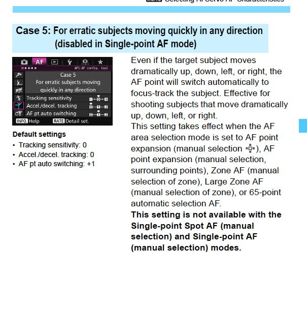

I have been curious about Canon's explanation about AF switching when it comes to expansion AF mode.
From the 7D2 manual
Untitled_zpsr4asovmw.jpg~original
The key phrase the camera switches it's focus to neighbouring AF points. My understanding is the surrounding AF points around the centre point in expanded are assist AF points. In AI Servo I never see anything switch. Ever. All I see is the centre point illuminated. Perhaps they just assist faster. If so I wish Canon would have worded it that way.
Personally I decided it does not make much sense so if I'm in Cases 5 or 6 I use zone where the AF points are actually switching. If you are tracking an erratic subject it just makes sense the more AF points involved the better. Especially in 65 AF for those really small fast birds that change directions quickly. Very difficult to track in expansion - even in 8 point.
Of course this is just my opinion. This is the only part of that entire manual that I have always questioned. Even the Canon PDF AF guide. I keep asking in case someone has found the answer on other forums but no answer yet.
That is my point. I view expansion as an extension of single AF point.
This is correct as it just mentions Single is not available in both cases 5 and 6.

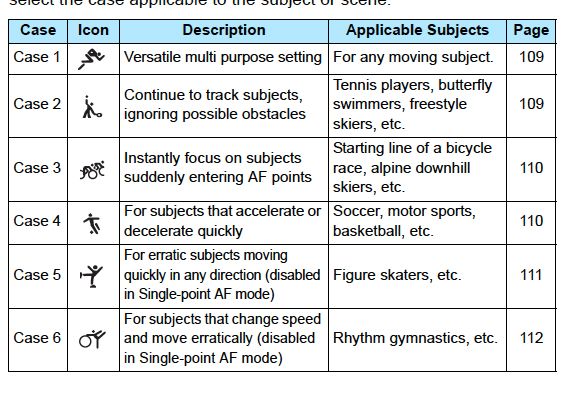

rere_zpscrhydhxo.jpg~original
I think Canon made a mistake here. It states it is available in both expansion modes. Case 6 says the same thing. In case 5 TS and Accel/Decel parameters are the same as case 1. The only thing that changes in Case 5 is AF switching.
