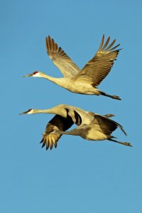

Of course the 70-200 with a 2x might be all you need but if your budget allows, rent a 300 f/2.8 ii. This lens on your FF with a 2x can be hand held, will still focus, and yields amazing results. I used that setup a few years back (and this image could be better but I was still new to BIF) and got this:

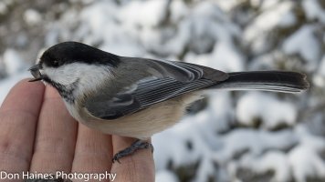

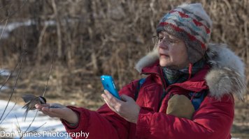

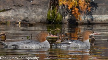

Three helpful tips......
The first is that with food, you can get birds to come close..... but it does take time and patience... you can lure them in close enough to use a phone (first picture) or with a 24mm lens (second picture)...
you can also set up a hunting blind..... I STRONGLY recommend bringing a chair and a good book... a snack, and lots of patience.... as the birds wander around, your opportunity will eventually arise as in the third picture, shot with a 70-200.....
The third tip is be quiet and be still. Sometimes, even if you are in plain sight, the birds will forget that you are there. I can float motionless in my canoe and let the wind slowly drift me towards my target and they don't seem to mind (picture 4)... this seems to work particularly well with ducks and loons and works particularly terribly with herons.... you have to know your birds!
Good fieldcraft is more important than great equipment......
