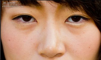

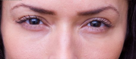

Im still looking for how these images will ultimately better than what my t2i can produce at iso 100. Ive seen plenty examples from others online, but as of yet i haven't experienced them with the 6d.
Here's some cropped, 1:1 eyes from my t2i. Can i realistically expect "better" from full frame?
