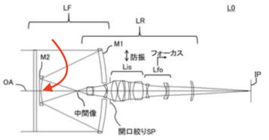

I think these new cats are about size and price. Note that the design appears to have flat glass at the front and not a doughnut lens, so the only large optic in the whole thing is the mirror and it appears that is spherical, so not hard to grind.
What makes you think so? They all have a secondary mirror right behind the front element.
The secondary mirror is typically glued to the back of the front element. In this case, the front element appears flat and the diagram shows the light rays coming straight in to a mirror of the same diameter. I did not mean that the lens would not have doughnut bokeh, but rather that the front element would not be ground lens of doughnut shape, which is typical of most cats (and the mirror is typically smaller than the front element).

I may have misunderstood your final sentence, but having "donut" bokeh is inherent in the design. The reflector behind the middle of the front element will automatically produce a "hole" in the bokeh.
Having used mirror lenses in the past, I took an instant very strong dislike to the effect. Donut bokeh won't appear in *every* image, but it will be particularly prominent in highlights on out-of-focus marine backgrounds, and that renders it useless (to me) for photographing waders, herons, gulls and other birds that frequent rivers, ponds or shorelines.
