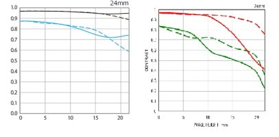

Does anyone know how the new RF 24 1.4 compares to the Sigma Art 24 1.4 optically? I have been using the sigma for landscapes and Milky Way and have been pretty happy with it, but it would be nice to have a native lens that is significantly lighter, especially considering the adapter. Coma would be a concern. Thanks!
you can't really compare MTF's between brands but a quick eyeballing seems to indicate it's better.
YMMV though.
Again, you can't really directly compare - but since the MTF's are vastly different, it's safe to say that the 24L is a much better lens. The Sigma may come close around the center though.
I'm not sure you can tell coma from an MTF chart though.
YMMV though.
