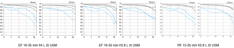

It's sad cause we can easily find differences on MTF charts between RF 85 1.2 vs EF 85 1.2 II, RF 50 1.2 vs EF 50 1.2, RF 24-70 vs EF 24-70 II, but with RF 15-35 vs EF 16-35 4.0 IS it's not so sweet.
I haven't seen anything but if that is so then EF16-35 2.8L III which is better than EF 16-34 4L IS will be better than the RF 15-35. But I will wait for Lens Rentals and TDP to test and compare. But both 16-35 III and 16-35 4l IS are very good lenses so an RF lens equally good shouldn't be an issue...
The EF 50 1.2 and 85 1.2 we're pretty soft however and there was a lot of room to improve. Arguably the 16-35 f4 is already quite a sharp lens and doesn't need improvement quite as much.
That said more sharpness would still be nice, especially with the rumored 80mp Sensor.

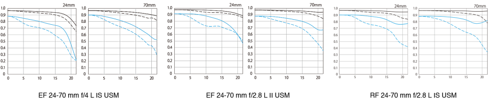

Just be careful which MTF charts you’re comparing, by which I mean where you find those charts. In 2018, Canon changed the way they calculate the curves resulting in a more stringent assessment. So, if you compare the same lens with the ‘old’ and the ‘new’ MTF method, the performance looks substantially worse on the ‘new’ MTF curves. For all lenses pre-2018 currently in the lineup (which includes all the EF lenses you listed above), Canon revised their MTF charts to the new method, and for a valid comparison you need to compare the RF lenses (which all use the new method) to those revised MTFs. BUT...while Canon Japan shows the updated MTF plots, other regions e.g. Canon USA did not replace the old charts with the new ones.
Kudos to @AlP above for using all new-format MTFs. For others doing their own comparisons, the easy way to tell is the old charts have 8 lines, the new ones have only 4 lines. Only compare new-to-new or old-to-old.

15-35 MTF seems same to worse, 24-70 MTF is a lot better at 24mm in the corners. But I'll wait for lensrentals to test RF lenses before looking at more MTF charts :)
I mean, a 15-35 (with 2.8 and IS) is still different to a 16-35, right? :) May not cause quite a stir like the 11-24 did, but it is still a good step forward.
