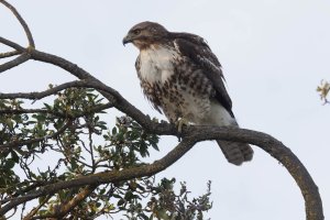

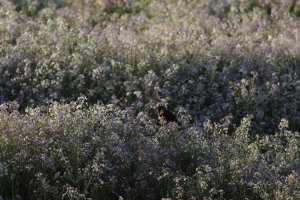

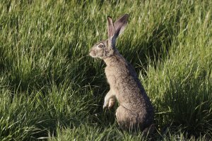

Many here know of my previous issue of multiple lock ups and crashes on my R5 which I recently had come to associate with my extensive custom setup of the camera. Since vastly de-customizing the camera and converting it back to "normal" except for a single BBF button and remapping 2 dial functions it had performed MUCH better with markedly reduced to rare lock ups. After reading Alan's recent post about not having lens corrections functions enabled, I turned those functions off and installed the new 1.5.2 software (was on 1.5.0--I was having so many crashes on it that I never went to the 1.5.1 when people reported focussing issues as well). I took my camera out to a wildlife refuge area yesterday and shot about 2500 pictures using both electronic and mech shutter, sometimes filling the buffer of birds and running hares. I shot only to the SD card which I've never done. I've always used the CFE card exclusively. I found the focus to be excellent, responsive, like I remembered my R5 at its best! I had NO crashes or freezes, which I certainly would have expected given my previous experience. We'll see if this holds up in the long run. I have 180,000 clicks on my camera to date. We leave in 3 weeks for a 6 week photo trip in Africa so I'm really hoping the problems are now settled down. My last couple of trips were marred by focussing and crashing issues so I will be glad to have this behind me if yesterday's shoot was any indication. Attached are some unedited, directly out of camera pics from yesterday taken with R5 + 100-500 + 1.4x
Catherine
Looks great. I hope this continues for you.
By any chance, have you had an opportunity to check what AlanF suspects about focusing close to MFD? Thanks!
