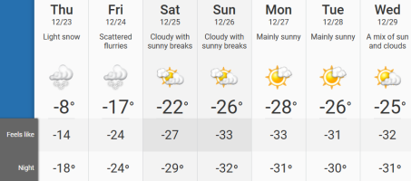

It's about to get a bit colder where I live. Not sure how much use equipment is to me when I can't use it in winter. I bought this lens for activities like skiing and hiking.
