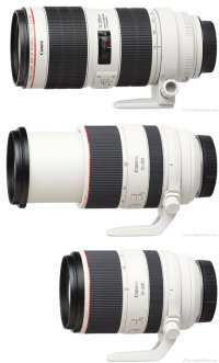

3) More smaller
keep specs the same, just do the magic on this that they did on RF 70-200
The RF isn't magical, it's just externally zooming. It's just a design decision. They did not cheat the laws of physics, bend light through the Tesseract or strike a bargain with the devil.
They just rethought whether the tank-like professional internal zoom build still made sense in 2020, now that the market has a nontrivial percentage of people who care about bag size.
An RF 70-400 could be smaller than the EF 100-400s, sure, but it will take more than what you see above to do that (because the 100-400 already does this).
- A
