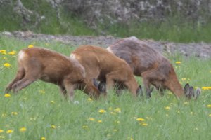

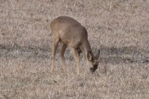

Camera and 800mm lens have now been tested and returned from Canon. They found nothing wrong but fine-tuned the focus. My own tripod test with 10 sec delay confirms good focus. However, in the field stabilized focus is highly unreliable and most of the time very bad. I am attaching picture before the problem started and a comparable picture representing my attempts to capture pictures with that lens today. Has anybody else experienced a similar problem ?
The second shot doesn't look like a simple focus issue as both foreground and background are also blurred. It looks like a stability problem. Was the second shot hand held or on a tripod. If hand held, what was the shutter speed? Does it improve if you use electronic shutter?
Edit: Downloaded the image and read the EXIF data: 1/30s and 100iso looks to be the problem - I'd be using 1/2500s and iso 800 for that type of shot. If you look at the blades of grass around the animals, you can actually see the double images from lens or shutter shake.
R6/RF800 combo here. I assume you were handholding and not a windy day. If so, I only see this type of result (second image) when the shutter speed goes too low while handholding. You might be expecting too much from the IS if you are setting ISO 100 and letting the camera choose the shutter. Often I set the ISO, but I get better results by setting the shutter and let the ISO vary with the RF800. Dxo PL4 (and others) do a nice job with higher ISO.
I'm not sure I'd go that slow, but at 1/30 I'd be on a tripod using a remote shutter. I can get good results at 1/250-1/500 if I have a fixed point (monopod, bean bag, window sill, etc.). Like Alan, I'm faster than 1/500 when purely handheld if I want a sharp result, 1/1000 if birds are involved. We all impart different amounts of shake. Give your combo a try on a tripod, fixed point, and handheld while varying the shutter speed to see if you get better results. This should confirm Alan's conjecture and help you find your sweet spot.
One thing to remember, the 1/focalLength shutter speed recommendation comes from film days when film "resolution" was generally < 16 megapixels. When we hit crop sensors, the recommendation was more like 1/(1.6 * focalLength) to compensate for higher pixel density without IS. I use 1/(2*focalLength) as a guide for my M6mII at 32 megapixels and would probably do the same with the R5. Meaning 1/1600 is minimum shutter speed without IS. This suggests you are looking for around 6 stops IS support at 1/25. Canon suggests the lens only provides 4 stops of shake protection so your result might be expected. I tend to be conservative, but it prevents fuzzy photos.

Agreed. It was hand held with tree support and stabilizer on. Test shots through the range of possible shutter & ISO combos show no marked improvement. By letting the camera choose within Aperture priority there is no real improvement either. This strange general lack of focus started suddenly after months of good pictures. On tripod with shutter delay the lens performs well, both at Canon and by myself, however, in the field it suddenly does not. Why suddenly so different from earlier ?
Thank you. Agreed. I have been impressed by this lens for BIF against the sky in spite of long distances. I have possibly come to expect too much while shooting larger animals on the ground, probably at even longer distances and with very different light conditions and exposure times. Also, earlier in the year with lower light angles from behind appears preferable to a sun overhead when it comes to animals on the ground. Thanks Alan and dcm, I will start using more rigid support for animals on the ground.

Your first image looks like a crop from a badly underexposed image that was post processed horribly, whilst being shot with an 800mm lens at 1/200 second. Your second image shows extreme camera movement being shot at 1/30 second with an 800mm lens. They were both shot at 100iso which is ridiculous given the shutter speeds you used.
If you want to sort out your AF 'issues' put the camera in Tv and auto iso, put the shutter speed at 1/1000 and the iso range to cap out at 12,800 in auto. But that isn't what you want to hear, what you want to hear is Canon are bad they should do something for you. They did, they checked it out and it performs within specs.
