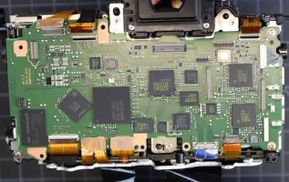

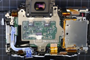

In this case the thing is connected to the sensor board. Here is the sensor PCB. Note the blue ribbon cable that comes off the sensor board (middle left) and folds down to the bottom left.
This cable connects to the main board as shown below:
The signals on this cable feed over to the Analog Devices part above and to the left of the ribbon connector attachment connector.
These signals don't appear to be going to the AV connectors on the edge of the camera (although, I also at first thought that).

Thanks. The second image is too blurry for me to read the PN, but I’ll take your word it’s an ADC.
Boy is that blue flex cable an ugly run...
Agreed. It could be a few things but the one thing that you can see clearly is the Analog Devices logo. The PN may be a problem anyway since the parts may have a special PN just for Canon. Semiconductor companies often times play games with part numbering. For example they may have a catalog part at a given price, they may offer that same part (possibly with a different pinout and some features killed or not tested) to someone like Canon (in large volume, at a significantly lower price) but mark it differently. That "different" PN may not appear in any catalog. FWIW: I come from the semiconductor business (now retired). That part bears a resemblance to a 10 channel part that AD makes.
