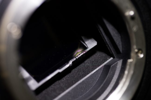

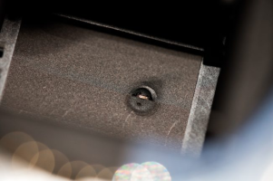

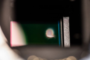

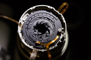

And when you say "need," you really mean it.
Not doing so would be akin to aiming a Burnz o-matic at your sensor.
Unfortunately, putting the filter in the sensor stack does nothing for the (600mm f/ 4) lens:
Or shutter:
or mirror:
But it does prevent this:
