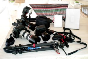

Dear Friend, Mr. Cristiano
One portable soft box/ Flash modifier that with me all the time = Graslon 4100F , But not Cheap = 80-100 US Dollars, but I can use with flash on the camera or off camera flash. With out afraid of strong wind at the beach( Umfrella or big sift box) or stick in some one's eyes but this great product give me a great soft light in every situation---dark area or bright sun shine.
http://www.canonrumors.com/forum/index.php?topic=20419.0
Enjoy
surapon
Ps., Here are my Equipment for Wedding Job. Out of country job.

With all due respect to Surapon, those little on-camera, postcard sized "softboxes" are totally useless.
If I understand, you want a real softbox, affordable and portable.

Thanks Dear Friend YuengLinger.
Thanks for your Good Comments, That Tiny Softbox are great ( In my Idea) , depend on the location of the Lights. In my case, I mounted on the Poles and let some one hold on at the side of me ( Main Photographer), and Another Light at let/ right sides of the Back of the subject (at high Level) as the Rim light/ Hair Light. If I have no one to help, I just mounted on my DIY Bracket as the Photos below = Work for me 100% in every times.
Have a great weekend, My friend.
Surapon
PS. The Last Photo ( N-1) is the Professional Wedding Photographer, my dear friend ( MS. Kim Crenshaw) on the Job , She use Graslon 4100D, Prodigy Dome , for her Job that make Money.
