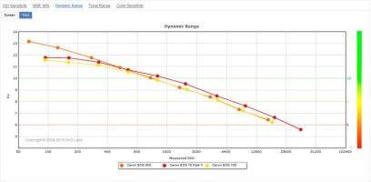

http://www.dxomark.com/Reviews/Canon-EOS-80D-sensor-review-Dynamic-performer
Highest ever DR reported by DXO for a Canon camera of any sensor size.

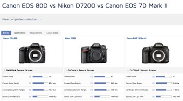

Still 8 points lower 'Overall Score' to Nikon's roughly similar D7200, which DXO rates better than many Canon FF sensors. ::)

Snapshot of the results, go to the link above for the actual tests and such.

The 80D sensor is rated far higher than that of the 7D II. But, for my purposes - iso usually set at 640 or more - the 7DII has better DR and slightly better S/N, and so would have a better DxO score for me.

How does one interpret effect of base iso difference (64 vs 100) in their day to day use. 80d snr chart is almost same as d7200 and a6300. But they have close to 1 stop DR advantage even at high ISO compared to 80d. d7200 and a6300 are pretty good. They do have measured ISO close to 64 instead of 100.
The 80D is slightly behind the 6D in their overall image quality assessment, so their relative score appears to line up with real world use.
The D7200 has a very good sensor. In DXO terms 5pts equates to about a third of a stop advantage, so 8 points equates to about a 0.53-stop advantage. When looking at the measurements the total appears to make sense.
The D7200:
Colour depth (0.9bit more = almost double the available color discrimination)
Dynamic range (1.4Ev more = more than 1 stop cleaner shadows)
Sport/ISO (14% higher ISO performance = barely noticeable)
