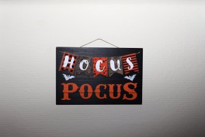

The banding I get is not caused by electronic shutter I’m afraid...View attachment 181792
I don't know what you're doing in this photo, but if you're pushing the image files more than 4 stops, this happened on my 5D4 as well. The banding I'm talking about is entirely different. It's consistent across the entire image.
Yeah, your banding is from the electronic shutter for sure (y)(y)
The issue I’m having is that the type of green banding you see in my shot is ONLY when having something in the hot shoe, so it is not normal for the sensor. And it shows up way before 4 stops, it’s just pushed to really show what it looks like
