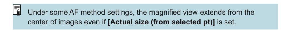

In image review, choosing magnify to actual size based on your selected AF point just flat out doesn't work. It always magnifies to the center of the photo, regardless of where your AF point was. This is a little frustrating. I was using singe point AF.
The camera got a little glitchy on me when using the 50mm f1.0L lens with the control ring EF adapter. Yeah, ok, it's a rare lens, but it shouldn't cause the camera to glitch out. At one point, it would not move the focus point to somewhere else on the screen when I tapped a spot on the screen, this was when using the screen as a live view shooting mode. Then, when I raised the camera to my eye, the EVF only showed the scene in front of me. All of the info that should have been overlaid on the scene in the EVF was not there. Turning the camera off then back on seemed to resolve this.
Screen. I also tried turning on the "display selected AF point" feature. That works, so the camera certainly seems to know where the selected AF point is, it just can't seem to manage to zoom in on it.

And yes, the “zoom inn actual point and 100%” absolutely simply doesn’t work, how can that get past QC?

Oh cr@p, the «zoom to 100% at actual point» works when I have a larger area I focus with and it just selects a single point within the area. I hope sooo much that isn’t just how it works in the R, it’s sooooo slooooow to scroll around trying to find where you focused(n) unbeliveable if it’s suppose to work like that....
^ Wow, thanks for finding that out...! I use this FREQUENTLY on both my 5D4 and 5DSR. Yet another difference to note...
Still, I think there'd be a workaround (I use this with my M6) - does pinch to zoom not work on the R? That would be *much* faster than manually scrolling around (but still not as good as a single button press)
