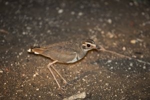

I fully accept that the AF of the R works with less light than that of the 5DIV and that can be a good feature, but I am very surprised that the light levels are limiting for AF for torch-illuminated wild-life on safari. The guides use torches to illuminate well enough that the human eye can see the wild life easily, and the 5DIV AF works in the near dark and the R when you can hardly see at all. What were you using to illuminate the wildlife - a match at 100 metres? I have never found the 5DIV AF deficient when the guide has been using a torch at night and I used centre spot focus. Here are two from a North Borneo trip. The top is a buffy fishowl eating a rat, taken hand held standing from the top of a bus at 1/20s and iso 6400, the lower of a buffy owl taken from a rowing boat at 1/15s and iso6400, both at 400mm and f/4 and cropped. Any less light than that would not have given me the quality I wanted, and that degree of light is virtually floodlighting compared to the -3ev lower limit for the 5DIV.

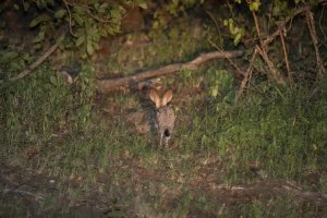

@AlanF. I agree, the 6dii and 5div autofocus is really really good with torch illuminated wildlife with the proviso that they are near, not moving and you have enough light and contrast. But try and focus on the lowly little shrub hare with its yellowish colour, yellow grass and the yellow light and it becomes very difficult to focus, and almost impossible when the hare is moving. The R still focus instantly, or nearly so, no matter far or near, still or moving, high or low contrast, yellow or white(led) light. As long as you can have the faintest of light on the animal it will focus.
Once again, the difference in autofocus performance, for me and what I am doing, is huge. Much much better than the spec sheets suggest. Like I said before, maybe I was using the mirrored cameras incorrectly?
Thank you. And how did you set up the AF? Was it center focus, for example!? What was the size of the AF area? If you want to show more detail, just crop the bird or hare and load that. It’s was useful seeing what you have uploaded so far.
