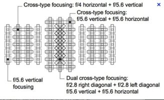

to be clear, if AF accuracy is the desired result coupled with the focus and recompose technique then what i am advising to the OP is buying the 5D3 would be a better option for him using his existing lens lineup and using the improved responsiveness of the 5D3's outer points when composing RATHER than buying 2.8 zooms and continuing to do focus and recompose.
yes, buying 2.8 zooms offers better AF on the 5D2...but any accuracy gained is wasted on the focus and recompose technique as the very simple physics of the technique circumvent the accuracy of the original focus acquisition...unless of course your are shooting at F4 and above with the extra depth of field that would compensate for the discrepancies introduced with the recomposition. at this point....a wiser recommendation would to be just buy the 5D3 to take advantage of better, more accurate focus points outside of the center point and ditch focus and recompose.
this is sound advice...which does not ignore your completely valid points about how AF systems work coupled with different lenses capable of different maximum apertures. your posts do ignore however the very real problems the focus and recompose technique introduces to focus accuracy....especially at apertures greater than F4. the OP should be made aware of this to help inform him of his decision.
i appreciate your enthusiastic points...but you are arguing something that 1. i dont disagree with and 2. doesnt have anything to do with the actual point that i am discussing.

Neuro: i'm saying there are better ways to solve the particular problem, one of them is a camera with more af points, more accurate af points, for whatever reason, say low light, f4 may not be desirable.

Actually, I don't find that particularly surprising. Here's the thing - an f/2.8 line is more accurate, but that accuracy isn't free. The price you pay for accuracy is speed. In fact, the predictive algorithms for AI Servo AF use mostly data from the f/5.6 lines vs. the f/2.8 lines, because the former are faster. Lens AF speed also plays a role, and the 50/1.8 is the slowest of the bunch.
