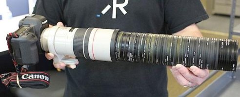

I wanna see a photo where somebody got like 20+ Filters on his lens :D And then everytime a new "which filter to use" thread pops up, we just show this photo with the kind words "as many as u can get!" :D
Boom. :-)
Ha ha ha ha ha!
Actually add a few more and you should be able to focus on the inside of the lens cap!
Or pull shadow details out of the surface of the sun. Long exposure, of course. ;-)
