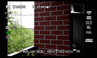

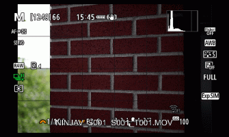

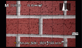

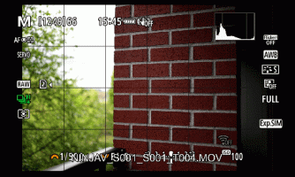

Just an issue with your 100-500's ? My wife has our 100-500 so I cannot test with it atm so I gave it a shot on the lenes I have on hand.
Not seeing any issues with the RF 70-200
Or the RF50 1.8
Or the RF 15-35
Even the RF 35 1.8 seems fine
Not the biggest gif (limited file size for uploads) but shows that I am not having to hit the back button assigned to spot AF multiple times to achieve focus. :unsure:
