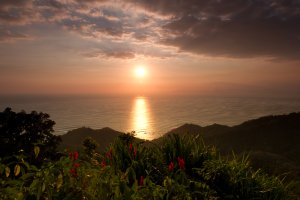

Landscape, include sun, don't blow highlights, maintain realistic detail in shadows without helpful reflecting surface? Done.
Done, I might add, with a 2008 Canon DSLR with a single shot and no clever processing or masks or filters of any kind.
Now I am the first to admit I can find the limits of the DR of my camera, but I believe I could do that with any camera because they are all comparable. What I can also do is mitigate any perceived 'limitations' it has to get the shot I want regardless of the scene DR. I shoot real estate that no on the shelf camera can retain the scene DR in one shot, none, no Sony or Nikon or anything else, if I need more DR than I can capture in one shot I take more than one shot!

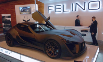

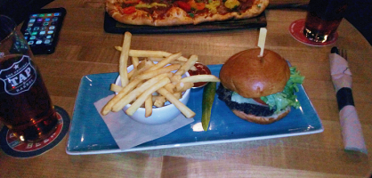

The following two shots, even though they come from a smartphone, with their mere minor shadow level lift editing and cropping, do they not symbolize a somewhat artistic interpretation of person's life?
"The Perfect Burger" and "Pretty Car" to me are NOT the mere assemblage of pixels taken by some $100 image taking device. They SYMBOLIZE a life I wish to attain and/or can enjoy right now! That is the essence of photography! The capture of a GIVEN MOMENT in our daily life! Who cares about banding or NOISE in our images, when YOU TOO can now enjoy the world's MOST PERFECT BURGER and a slice of the automotive high life!

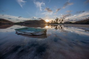

What's fun, is so is the sun in Michael Mavin's shots.....
I am not sure what camera he used for these, so they may not be perfect examples. In some other shots of landscapes with the sun in them, he was using the Canon RP. These, he didn't seem to specify. But, maybe these are not his "serious" shots.
This was with the Z7:

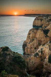

A few of mine, taken on 7D, 5DIII, and 5DIV (last one). This really isn't my style or what I typically shoot, so I am not trying to hold these up as something great. But, more to say, even a hack such as myself can take reasonable landscape shots with the sun in it with Canon gear. Even "old" Canon gear.
184214184217184218
Fail. Sorry, but the sun itself in your image is clearly blown out. Obviously, you need to be able to see sunspots on the surface of the sun and complete detail in the deepest shadows of the landscape, and in your case since you mentioned reflections you really should’ve used a circular polarizer to enable imaging of the underwater depths, where you should be able to distinguish the flounder from the sand after pushing the unlit ocean floor to daytime brightness. Face it, if you can’t do that then your image sucks. Just sucks.

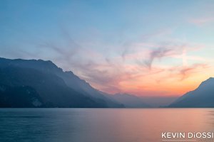

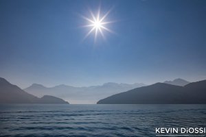

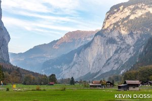

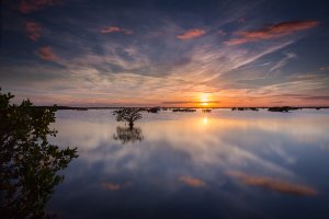

I like Michael, but when he said he could finally recommend the EOS R to landscape photographers, I laughed. It's so ridiculous to imagine this being a factor.
My 5D Mark IV and EOS R have the banding issue described by Michael.
I've been shooting images professionally for over a decade and landscapes are one of biggest hobbies away from my normal work. My career was build on cameras much less capable than the 5D Mark IV. The Mark IV has a truly spectacular sensors for photographers that know how to actually take images and don't just shoot crap and try to save it in post. Sony sensors are more capable, and I often see many unskilled photographers boasting about their camera's performance because -for them- it might be a necessary crutch for their lack of skill.
184221
184222
184223
The banding issue was legitimately only a problem in a handful of images on the Mark IV over the past couple of years. I'm extremely satisfied with the EOS R as well and I look forward to testing if my banding is gone as well.
