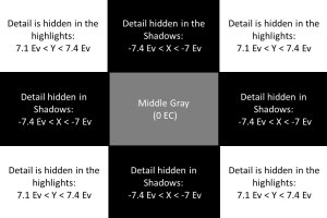

neuroanatomist said:msm said:neuroanatomist said:But some people – well, one person – apparently can't seem to come to grips with the fact that a screen DR of 13.9 stops means information in a scene that exceeds that range will be lost and unrecoverable. I suspect you can explain it more effectively if you choose, but I wouldn't bother.
Yes please looking forward to seeing that explanation. Particularly want to see the explanation of how I was able to recover information from a 16 stop underexposed image from my A7R, considering it has a "screen DR" of less than 13 stops and "information in a scene that exceeds that range will be lost and unrecoverable". ;D
Pointless as stated, but I have about one minute while my coffee brews so once more into the breach...
What do you need explained? The fact that a range has both lower and upper bounds? The fact that DR is a measure of the difference between those bounds? The fact that your 'proof':
...is so ridiculously far from simultaneously exceeding both of those bounds that it would be funny as a joke, but is just pathetic for your intent? The fact that the bounds of the range are defined by physics (FWC and read noise in e-), and not by any relationship to your camera's arbitrary algorithm for selecting a matrix-metered exposure on which your claim of a 16-stop underexposure is based?
