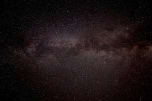

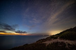

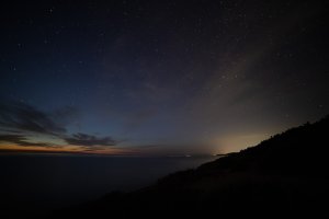

Had the chance to use the R5 for astrophotography
Nothing earthshattering here, but... In both cases I raised the contrast a bit, in one case I cropped out really bright ground.
The really bright "star" is Jupiter, up a bit and well to the left, that second brightest "star" is Saturn. They're going to get a LOT closer to each other in December...close enough to possibly appear in a telescope simultaneously. 24.0 mm 10sec, f/2.8, iso 10000.
The continuation of the Milky way upwards from the horizon takes you into the Summer Triangle (if you're in the Northern Hemisphere). Same exposure info. The bright star top and center is vega, the brightest star in the lower right quarter is altair, and Deneb is at about mid height, a quarter of the way into the image from the left. to the right of Deneb are three stars (fairly widely spaced) that form the "crossbar" of the northern cross, the other two stars in the vertical (which is horizontal in this picture) are a lot harder to pick out.
Steve - as someone who has never tried this, what lens did you use to take these images? I’ve heard “the faster the better” But I’ve also seen some good images taken with the 16-35 f4..
Curious on your opinion.
I had never tried this in particular until two nights ago. (I had to give up the first night because the moon came up--the moon will blast the bejeezus out of this whole endeavor.) I used the RF 15-35 f/2.8 L for these. (I think I gave all other settings in the post--and I stole those from FRO's video on taking astro pictures with the R5; he did show some starscapes after his planet shots.) "The faster the better" is a good principle, but an f/4 should be fine...if you're willing to double your exposure time, or ISO, or some combo that adds up to a stop, to compensate. Zooming in I see short star trails so I'd not want to go with a longer exposure unless the ISO noise is intolerable.
I was originally thinking of getting that f/4 in fact, but decided at the last moment to splurge on the f/2.8 and then was talked into going RF native for yet more money (a smaller step though than going to 2.8 in the first place). The lens is bigger, but not hugely so. I'd certainly not bother ugrading for this! (I had no wider full frame lens before this than the pancake 40mm.)

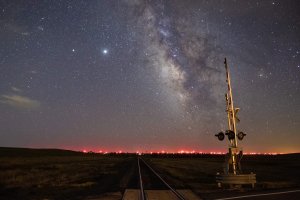

A few perspectives from my experience. I shoot astro with the 5DSR and a Sigma 14mm f1.8. As was stated previously, the faster the lens the better. I own the 16-35mm f2.8 but will only use that in a pinch. I also own the 11-24 f4 and haven't tried that at 11 and f4 but might to experiment a bit. The challenge with a 16mm f4 shot is you are definitely going to get star trails above about 20 seconds. As a result you will need to be shooting at 3200 or 6400 ISO to get enough light to not have to lift the exposure a lot in post. As was stated, lifting higher ISO images in post introduces a ton of noise and it is quite difficult to deal with.
I have heard great things about the potential of the R5 (which I have on order) for high ISO noise handling compared to the 5DSR. I can't wait to test it out. I would gladly work on someone's raw image if you want to shoot a shot of the milky way at f2.8 (or faster if you have it), 16mm or wider and ISO 3200 or 6400.
I am really hoping Canon comes out with a comparable 14-24 lens that is either 2.8 or my dream lens f2.0! I know it would be a beast, and expensive, but it would be the ultimate astro lens. I will keep using my Sigma in the meantime. It is quite a nice lens.
