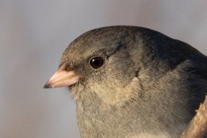

I had been thinking of doing a fairly detailed side by side comparison of birds at my perch with the 24 MP R1 vs the 45 MP R5. I can start doing a few comparisons even though they were not side by side, such as:
Taken in January. Junco...R5 1/1000, f/8, ISO 1000, 500 f/4 II w 1.4 tc so @ 700 mm.
Vs a shot taken early this week, another Junco, R1, 500 f4 II w 1.4 TC, 1/3200, f/5.6, ISO 6400. So, not the same settings at all, but...
I can see a bit more detail in the R5 image, particularly in the feathers under the beak, but that may just be the difference in DoF from f/5.6 to f/8 at 700 mm.

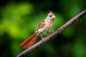

So, much more interesting to me, I thought I would share 3-4 of my favorite images from each camera. Starting off with the 20 MP 1Dx III which I had as a loaner before I bought the R5.
Next up, the 24 MP R1 (which admittedly, I have been testing at lower light/higher ISOs....so some IQ differences)

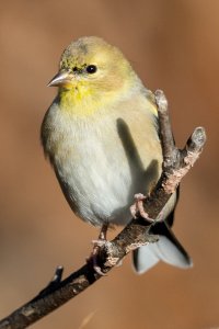

And finally the highest pixel density, the M6 II at FF equivalent of 82.5 MPs
I have tried to match up some of the birds. I can see a difference in resolution (or lack thereof)....but it is really most pronounced as you get to the M6 II and it's 82.5 MPs. The goldfinch image on the M6 II is much more resolution than the other cameras). But, I recall the miss rate with the 5DIV and M6 II was incredibly high. I would delete a very low keeper rate. The R5 changed that with the animal Eye AF.

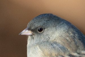

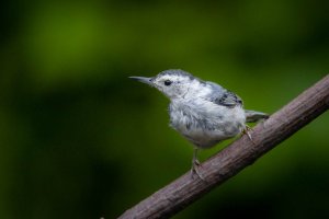

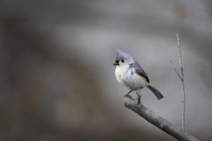

View attachment 221427View attachment 221428

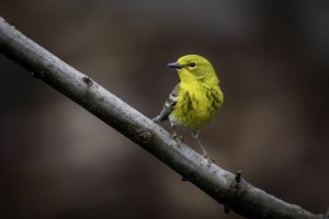

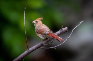

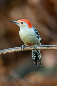

View attachment 221429View attachment 221430
They are all very nice shots where the IQ from all is very acceptable for me. But, the conditions vary far too much for a scientific analysis.

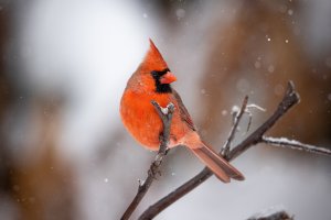

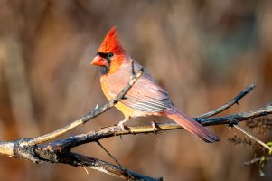

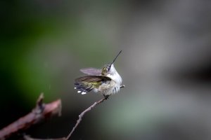

View attachment 221438View attachment 221439View attachment 221440
