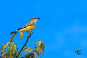

Great is always subjective :) .. as others indicated, sometimes when you travel and space is an issue 70-200 + TC is a better option than two large lenses. Correct the quality isn't same, but getting a shot is better than not at all because you left you other lens at home. This was a decent example with 70-200 2.8 v1 and 1.4x tc v1. Had to downsample to upload here. This is 280mm on a Canon 80D (so also 1.6x)
